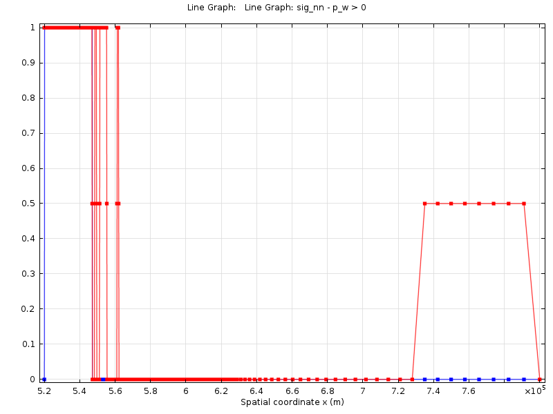

I have a problem with binary operators. As you can see in the attached image, the binary operator
sig_nn - p_w > 0
results in 0.5 for some points. Can anyone explain that to me?

Is there any chance that at those points are located at the interface of one domain where the operator evaluates to 1 and one domain where it evaluates to 0?
