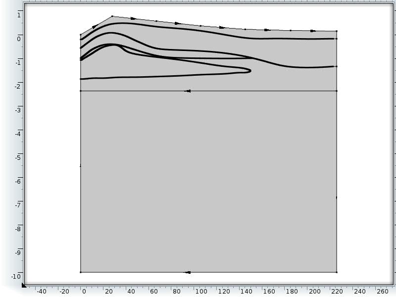

Hi ,
How is it possible to know value of special location in the surface that has not been defined as a point?
For example I want to know the value of Hydaulic head in a cross section fo soil column that I defined in 2D model for 20 different parts inside the surface?
Attached the snapshot of my case study.
Thanks in advance for your help.
Sepideh
3 Replies Last Post 20 ago 2014, 09:32 GMT-4
Posted: 10 years ago 19 ago 2014, 21:45 GMT-4
After running your model, simply right click on "Data Sets" use "Cut Point 2D", then make a point graph with "Data set" selected to the name of the defined point.
