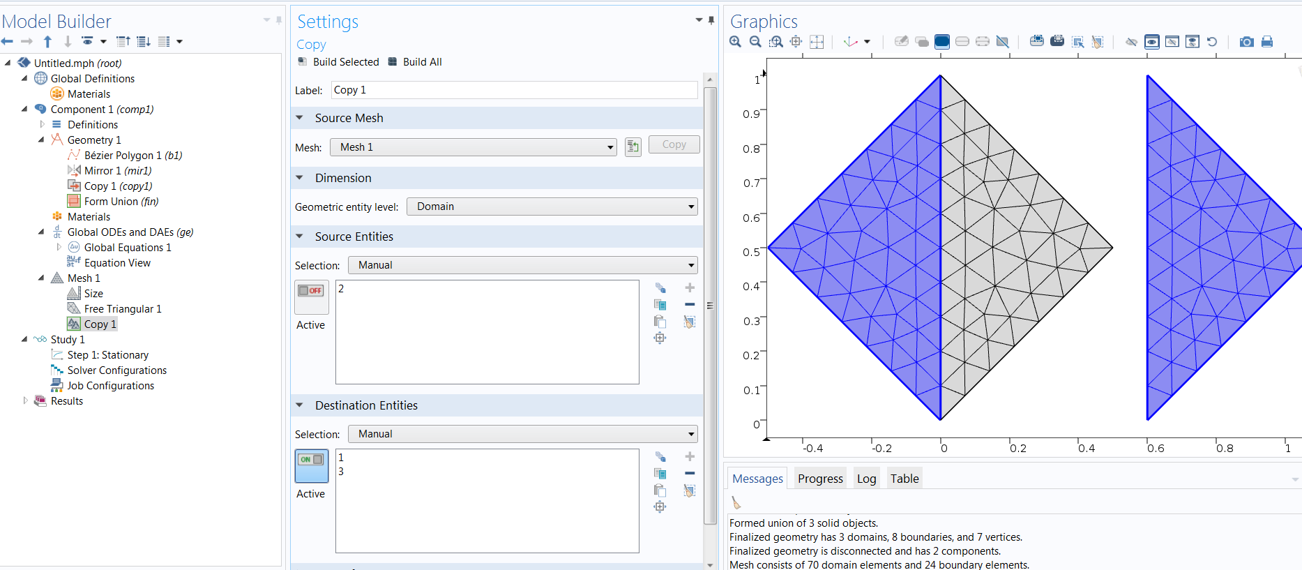

I read a lot of your discussions about symmetrical meshing. Do you know if they already built a "mirror mesh" operation? I only found "Copy Domain" and "Copy" in the mesh subnotes. But these two operations do not really solve the problem for mirroring a mesh.
Do you know anything new? Or do you still work with splitting the geometry and "copy mesh" on edges, etc...?

Normally if your part is symmetric the "copy mesh" will automatically detect this and make a symmetric copy hence you get your mirror operation, but I'm not sure if it's capable of a central symmetric mesh operation.
Try it out with a "sand case/toy-model"
