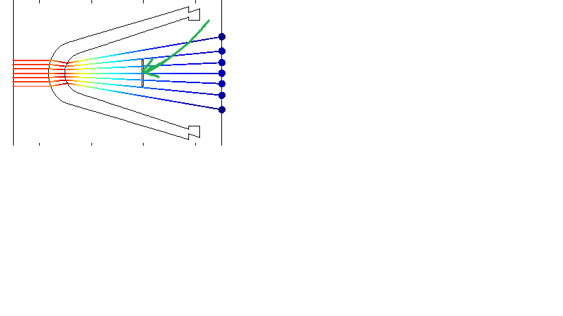

I actually set the "Intensity computation" property ,that can compute ray intensity and polarization .
The exact question is that ,how can i compute the sum of ray intensity reached a specific line .geometry image is attached . The green arrow indicates the line(The sum intensity should be computed in line)

Hi, the intensity only exists on the rays themselves, not on boundaries or domains. May I ask what you are trying to compute? If you are interested in the power transfer from rays to a surface, you can use the "Deposited Ray Power" boundary feature. AN example of how to use this can be found i the model Model Libraries>Ray Optics Module>Industrial Models>solar_dish_receiver.

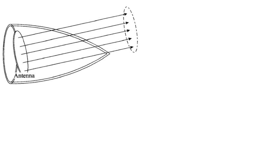

I actually want to calculate far-field radiation pattern of an antenna that is extremely large .
as dimension of antenna is much more than lambda , simulation cant be run in RF module. I have to use geometrical optic .
i am interested in power(intensity)distribution on an equivalent aperture as showed in attached image .
is it possible to change equation of geometrical optic module such that ignore refraction of rays on Material Discontinuity?
as showed in attached image, rays don't refracts as arrive new environment
