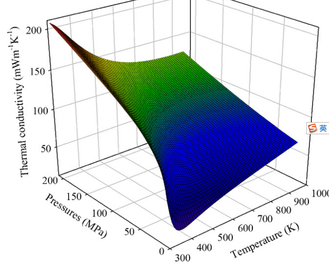

How to use COMSOL Multiphysics to draw a picture like below??
Tks

Dear Shirley,
You can import the data to an interpolation function. This allows you to create the image as wanted.
If you have an analytic description you can even do it in an analytic function.
Just use "create plot" and see how COMSOL builds a plot like this.
Frank
Dear Shirley, You can import the data to an interpolation function. This allows you to create the image as wanted. If you have an analytic description you can even do it in an analytic function. Just use "create plot" and see how COMSOL builds a plot like this. Best regards, Frank
