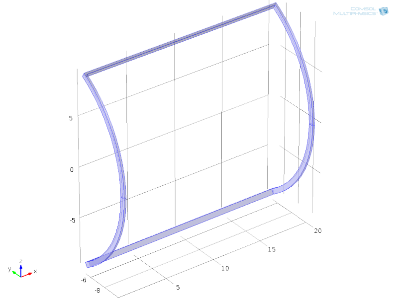

Here is a screenshot of the domains I selected for the coil in my model, and I can't figure out why I can't use gap feed to specify current direction.

In the model you attached in the first post, the whole saddle is selected and the gap feed extends all across the saddle, which doesn't make sense.
I corrected your model and now it solves. Two more remarks. In mf the non-conductive domains mostly need a small conductivity and you have to add a 'Gauge Fixing for A-field' node to achieve convergence.
Also I would advise to assign a material or realistic conductivity to the coil domain to get meaningful coil parameters in the post processing.
I am attaching the rectified model.

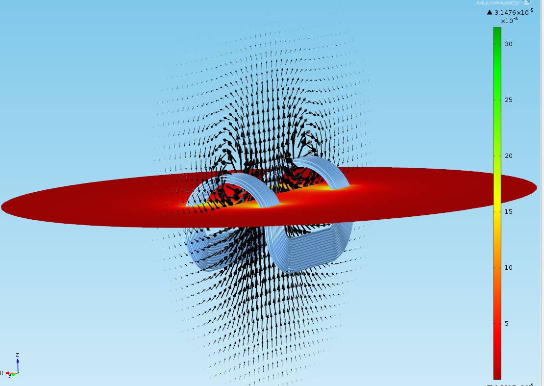

Actually I am trying to design a model of gradient coils for use in MRI. I really need to know how i can design a saddle coil geometry and run the study to get the magnetic flux .
thanks in advance
Actually I am trying to design a model of gradient coils for use in MRI. I really need to know how i can design a saddle coil geometry and run the study to get the magnetic flux . thanks in advance

Well,i checked it , you really did a great job , actually i am beginner and i trying to design a model like the attachment photo , and how i can change the current in the coil to the opposite direction .
Best regards
Well,i checked it , you really did a great job , actually i am beginner and i trying to design a model like the attachment photo , and how i can change the current in the coil to the opposite direction . Best regards
Posted: 1 decade ago 14 mar 2015, 17:32 GMT-4
Multiply with -1 ? This will also change the sign of the flux, nothing more.
