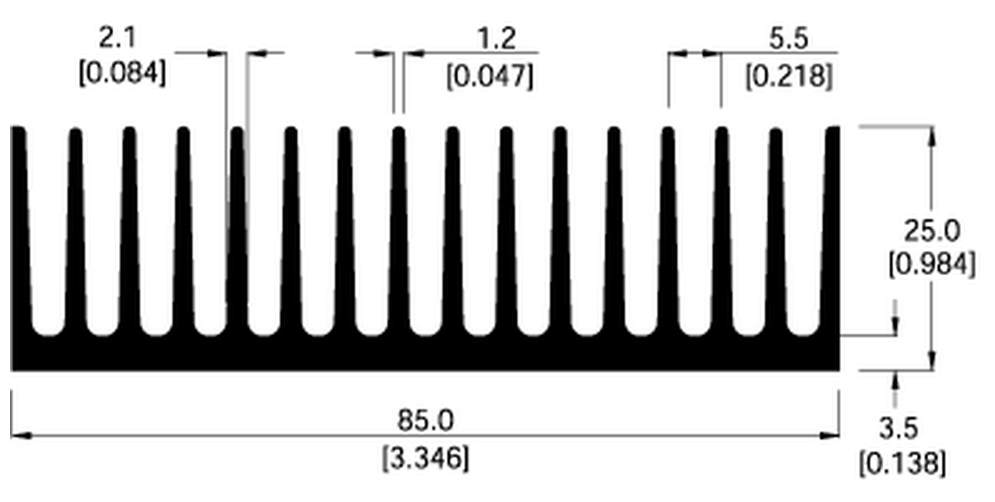

I'd like to model a certain Aavid heat sink that has a profile that can be seen in the picture I'll attach. I'm new to Comsol so I don't have much experience with creating objects of certain profile. I'd know how to create a heat sink with normal fins but this one is a little bit tricky for me as it has a bit inclined and curved fins. I also considered doing the profile in Solidworks and importing it to Comsol, but I'd like to stick to Comsol for the moment.

I would suggest to draw one fin as a polygonal line with a trapezoid shape, apply fillets to the edges and corners, multiply it with an array node and add the end and bottom portion. If you need it in 3D you can extrude this shape from a workplane.
