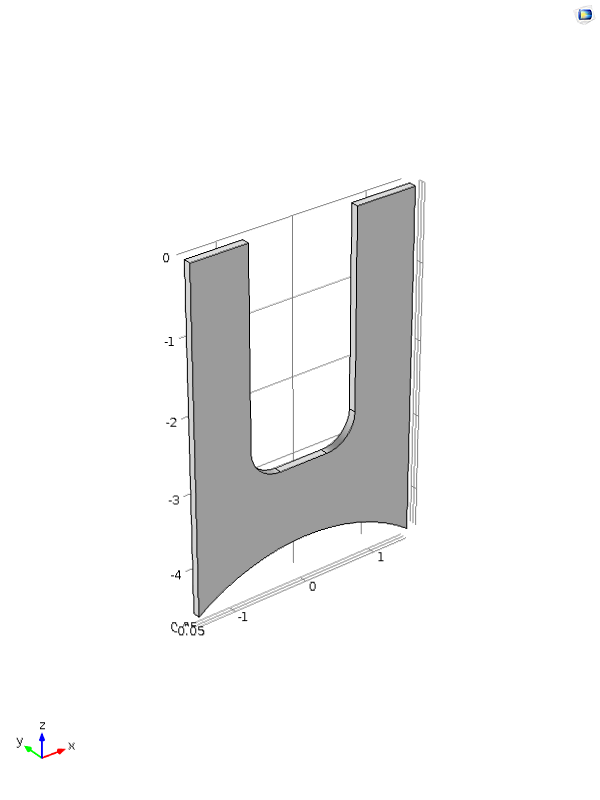

I would like to determine the displacement of a point of a leaf spring.
Unfortunately, the result is highly different from the actual construction, I proceeded as follows:
- 3D Model
- Solid Mechanics (solid)
- Stationary Study
- Geometric Imports (Figure 1)
- Material (brass: E=110[GPa], rho=8.44[g/cm^3], and nu=0.37[1])

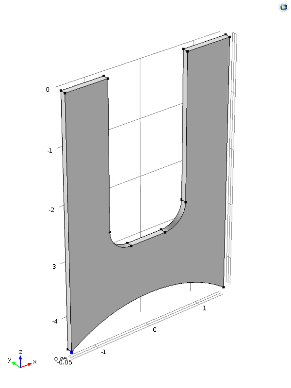

- add Fixed Constraint 1 (Figure 2)

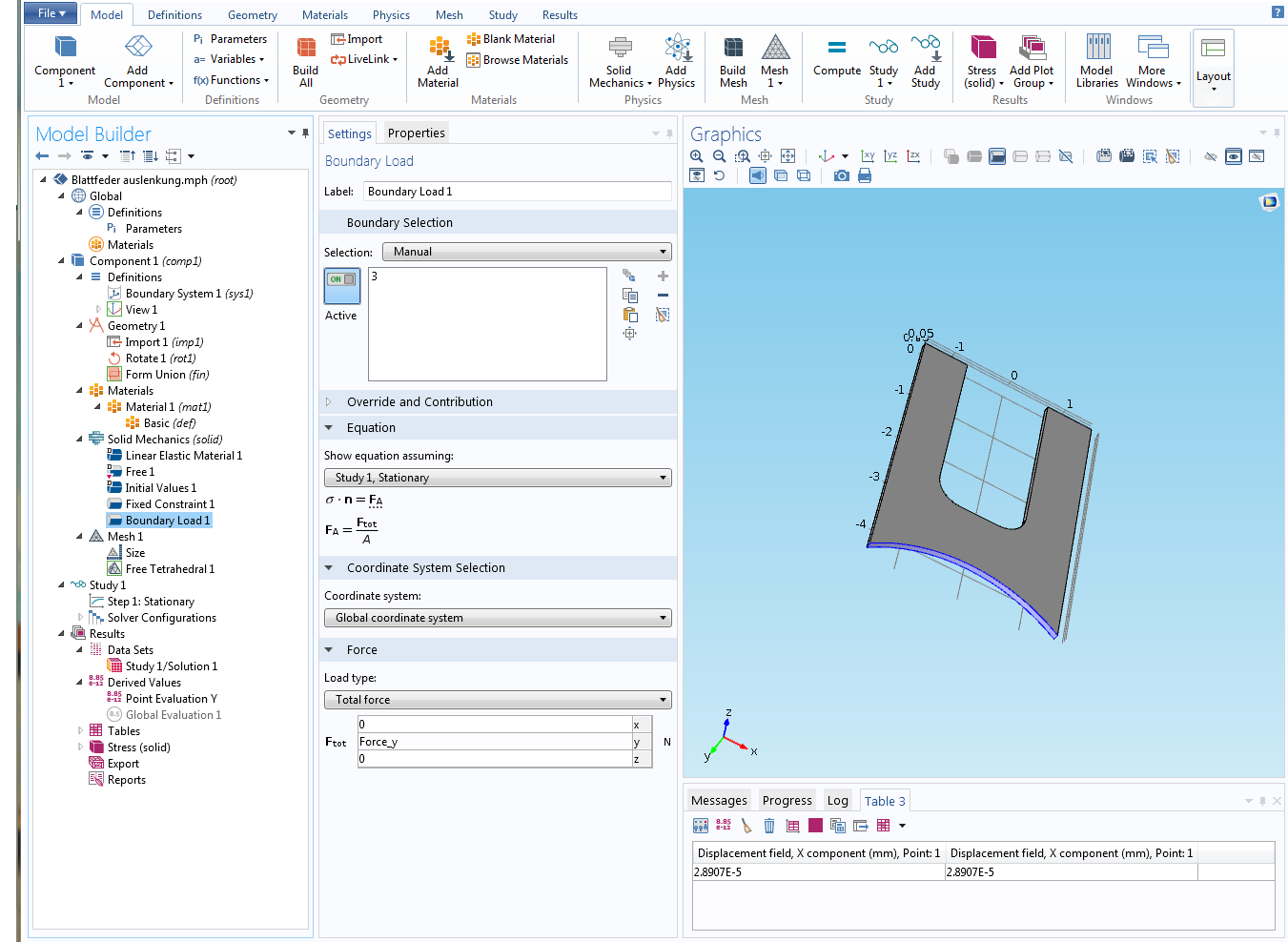

- add Boundary Load 1 as Total force in y (Force_y = 40[mN] Figure 3)

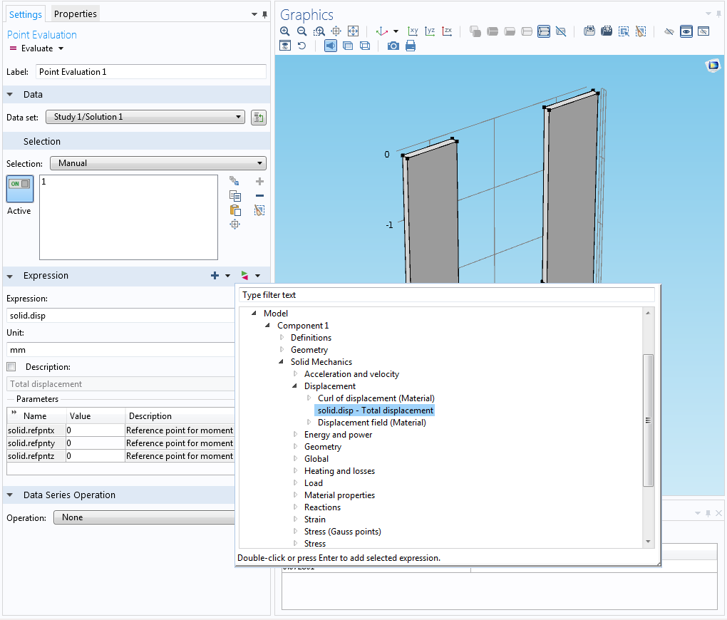

- add Point Evaluation Y (Select Point Figure 4)
- use expression Model -> Component 1 -> Solid Mechanics -> Displacement -> solid.disp
or Displacement field, X, Y and Z component

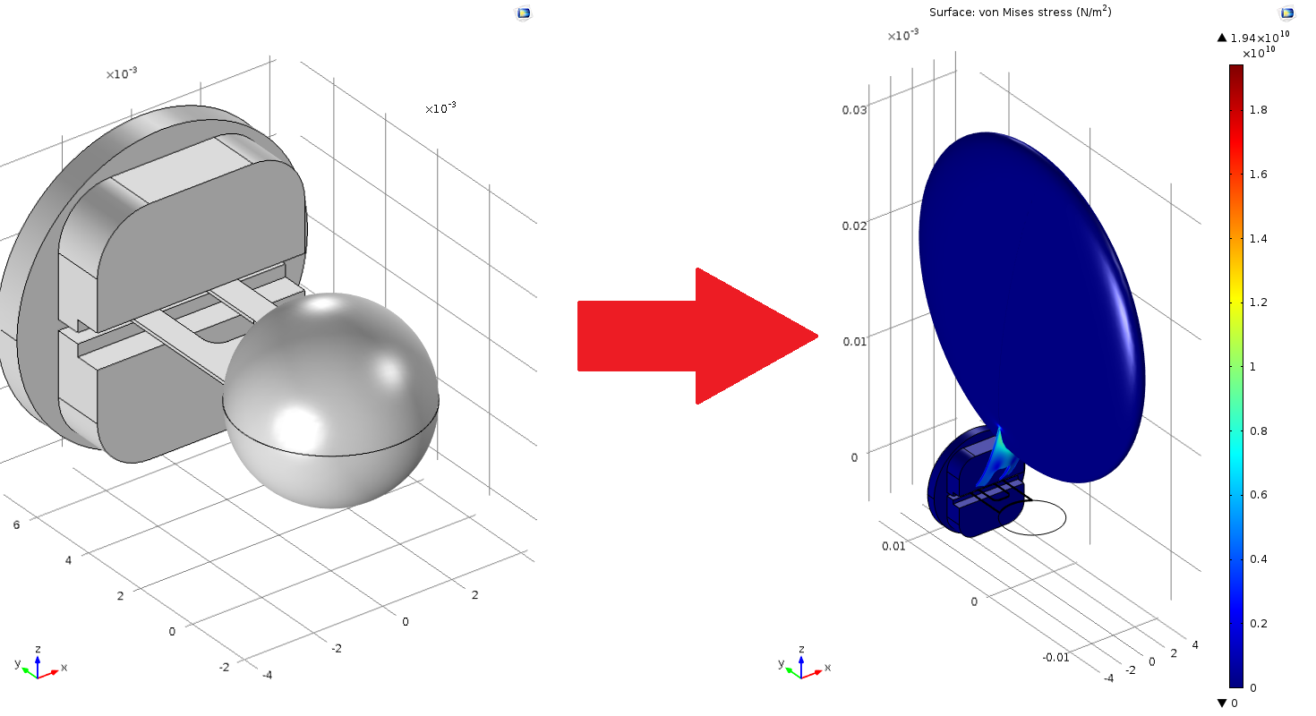

Furthermore I customize the model, insertion of a titanium ball.
I noticed that the titanium ball strongly deformed. It would be very nice if you could view the model and can give me tips.

I didn't see any deformation of the ball, but a very large deformation of your thin blade, so I would suggest that you consider the non-linear geometry mode for such large deflexions, and compare your results.
Another point is do you have a static X body load or a "follower" ball-section-normal load, for these deformations that has some importance

I noticed that the ball is very strongly deformed at very low forces (F=2 x 2N) and for the ball i used Structural steel as material (Build-In).
In the picture you can see the big deformation, can somebody say with what I'm doing wrong?

it would be great if someone can give me a hint again, because my ball of steel are deform very strong at even 2N force.
This may not agree with the reality ;)

sorry for pushing this contribution again. Unfortunately, I'm stuck with my Simulatuion, the deformation of the steel ball is still too big for my used force (see picture in the previous post).

Looks funny indeed, but your stress is also very high !
at least 100-1000x above yeld stress so I suspect a unit isue in your BC/Domain load there.
And you might have turned on "automatic" scaling ? that gives different scales for different directions
