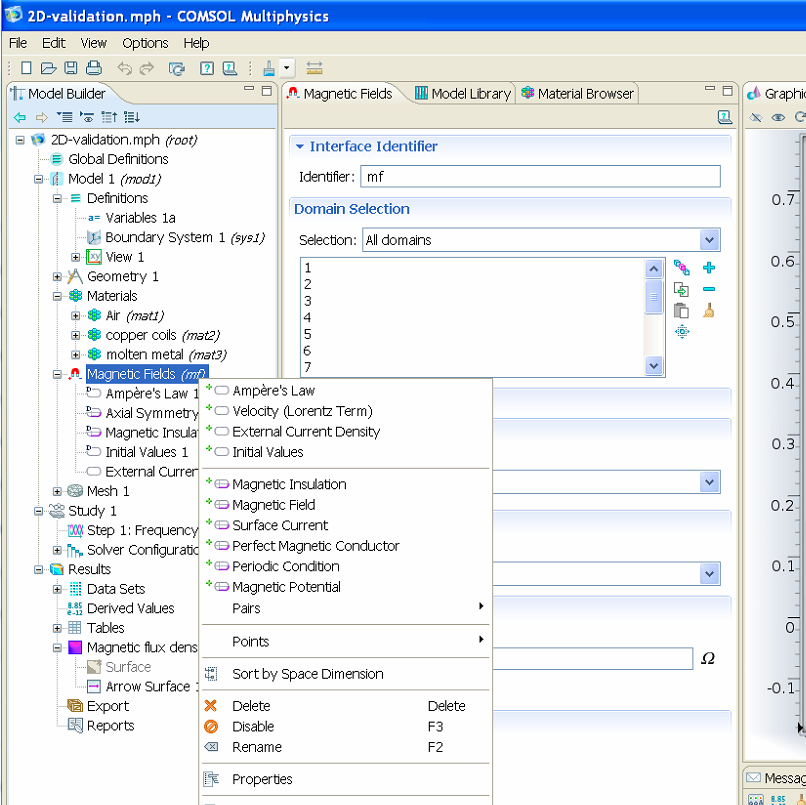

You are right, it is domain feature. But I cannot see "coil domain" after right-click on magnetic field in Model Builder, as shown in attached picture.

Yes there are many options missing. I have no idea why. Is this really version 4.3? You may have to ask the COMSOL support.

My question is whether it is possible to use "external current density" instead of "coil domain" or not?

You can assign an external current density to a domain. You have to take care that the current loop is closed or the current goes to an outer model boundary.
For a coil like that in the example it could look like Ix = I0*-y/sqrt(x^2 + y^2), Iy = I0*x/sqrt(x^2 + y^2), Iz=0
This gives a ring current with constant current density. However it is not exactly identical with a single turn or multi turn coil domain.
