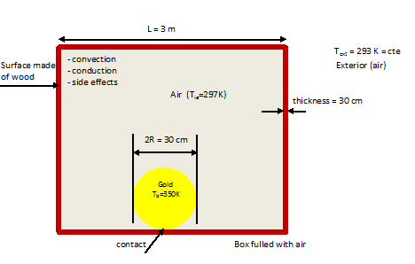

To be clearer, my sphere is enclosed in the box fulled with air. The sides of this box are made of wood and the system {sphere + box} is embedded in air (infinite medium). According to experiments, the finite size of the box is to be taken into account in the calculations of the cooling of the sphere and all of the physical phenomena relating to the cooling of a hot body (convection, conduction...).
The box represents a wooden house...The design can be seen in attached file.
Than you for your help.

You need the overall heat transfer coefficient of the wood wall, k_tot:
1/k_tot = 2/k_(a/w) + h/l_w
where k_(a/w) is the heat transfer coefficient between air and wood (I do not know where to find it), l_w is the heat conducivity of wood and h = 30 cm (thickness).
Next, what is the contact area between the gold sphere and wood? Can be a point.
Provided that these constants are known, the problem is solved. Use the Newton's cooling law for the heat flux between interior and exterior air (the latter is constant): Q = k_tot*(T_out - T_in).
At the contact of gold and wood yet another heat transfer coefficient is needed. If no BC is given here, the temperature profile is continuous, T_gold = T_wood.
The contact gold-air in the box can be treated in various ways, perhaps a thin barrier could be the simplest solution.
I wish this was helpful.
