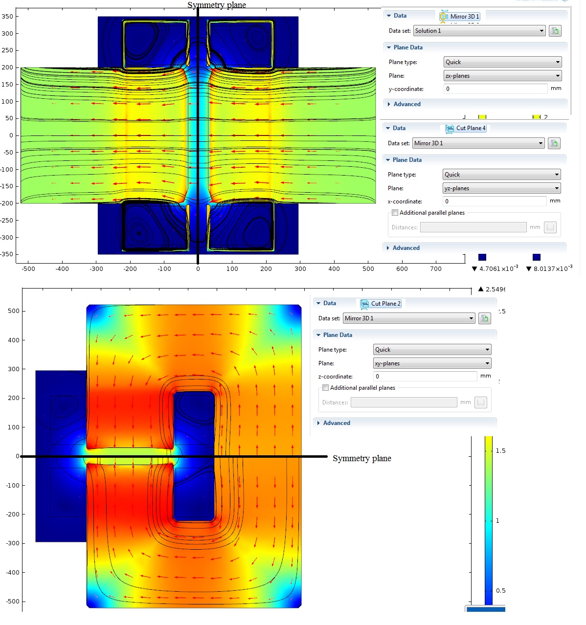

I define the cross plane on zx at y=0, to cut my geometry and solved it. On this plane I set PMC condition.
In dataset I define a Mirror 3D for Solution one, setting zx plane at y=0.
Now if I define a yz cutplane for the Mirror 3D dataset I have the correct solution of the model (magnetic field flows in only one direction along the yoke)
If I set a xy cutplane for the Mirror 3D the magnetic field flows in two directions and the plot look abviusly wrong.
PLease have a look at the attached image.
I did not used any other periodicity or bounduary condition to solve the model, only the PMC.

OK I believe I got it, (its easier to understand with an image ;) but in your case its not a simple symmetry plane, as your flux is going through the plane=> anti-symmetry for the flux there
Clear the mirror condition with a symmetry condition will invert the arrows !
Some symmetry cuts, in multi-physics, need to be set accordingly (symmetry and/or anti-symmetry) depending on the physics

A symmetry BC means that the flux is normal and that if something moves away from the surface it will move away from the symmetric surface. Anti-symmetry keeps the flux normal, but what moves away from one side point towards on the antisymmetric side. It controls the sign of the flux.
From your image the way you have cut your domain it looks like you should have antisymmetry on some of the fluxes, even if you want symmetry on the geometry and shape.
Try it out on a simple model a cube cut in two with current passing

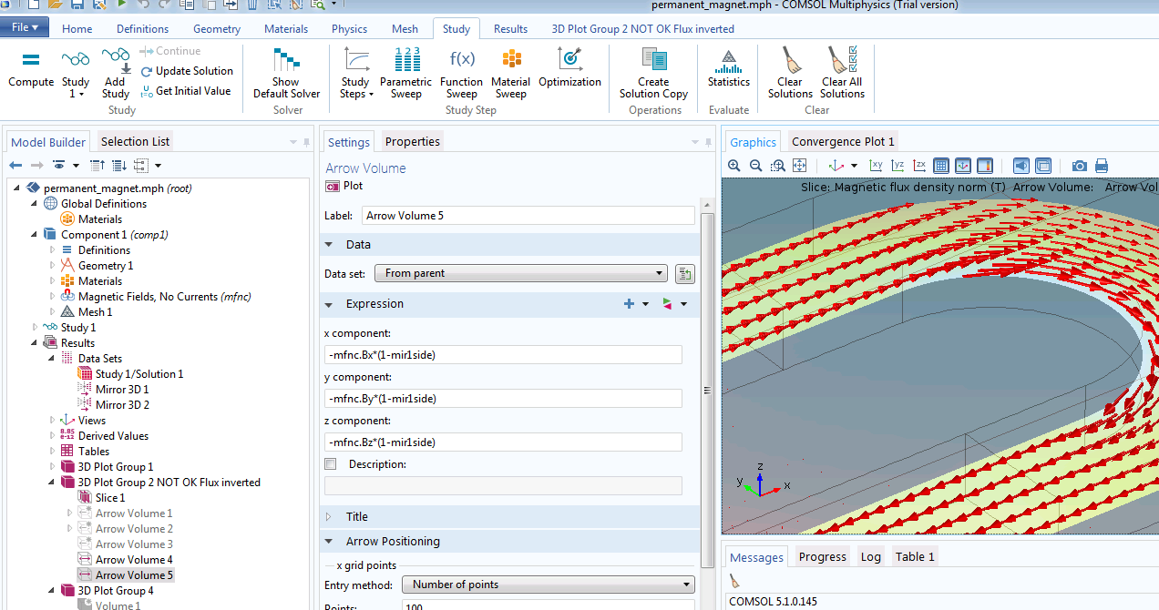

Hi here you have an idea
You must turn on the Advanced feature to define "mir1side" and then
the Arrow plot 4+5 do work, while Arrow 1,2 & 3 do not or give strange error messages for case #2 while #3 should also work
the model file is in V5.1
Hi here you have an idea You must turn on the Advanced feature to define "mir1side" and then the Arrow plot 4+5 do work, while Arrow 1,2 & 3 do not or give strange error messages for case #2 while #3 should also work the model file is in V5.1 -- Good luck Ivar

But if you copy the formula from the image PNG file you should manage, the formula for arrow 4 is
+mfnc.Bx*mir1side
etc for y,z
And you "turn on" the variable "mir1side" under the Data Set Mirror node Advanced Tab => select tick on

This is what I did, but doesn't work...

Anyway support told me so far to multiply the mf.Bx or y of the arrows times sign(mir1y) which is similar to your solution.
The problem is still there in my opinion and it is not solved at all for (I mean visually) the streamlines
Hello, ok, pairs are not good for my case, I understand. Anyway support told me so far to multiply the mf.Bx or y of the arrows times sign(mir1y) which is similar to your solution. The problem is still there in my opinion and it is not solved at all for (I mean visually) the streamlines
