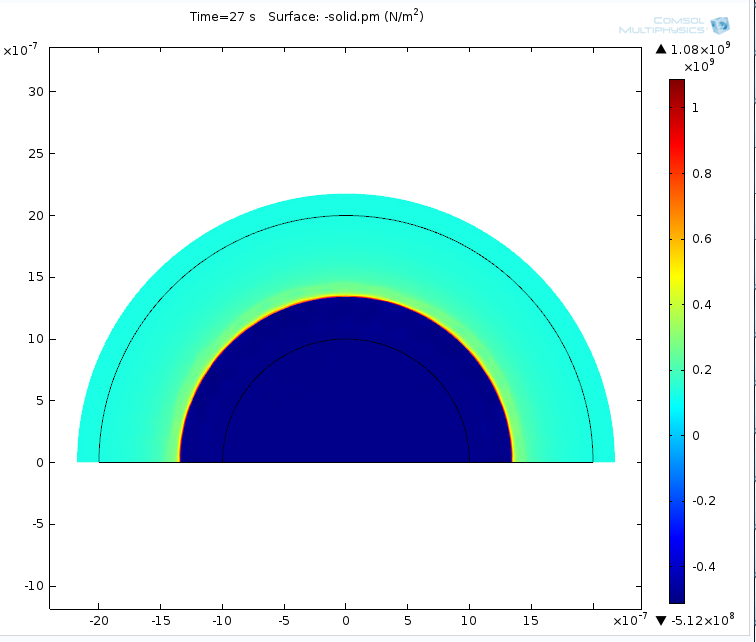

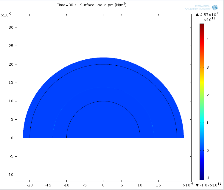

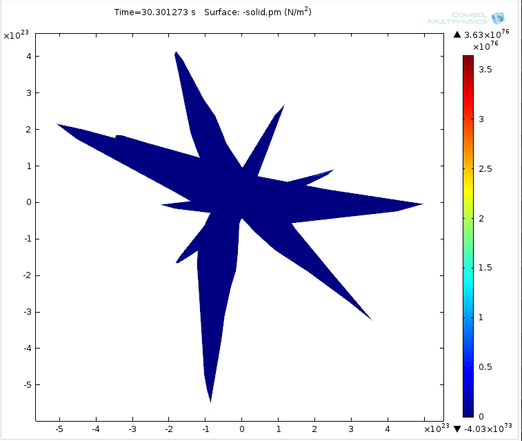

I also found when I even added a homogeneous temperature field on the center part, it cannot converge at some time. I think it is a very simple problem with large deformation, and in ABAQUS it can work well. But I don't know why I cannot handle with it in COMSOL. Attached is the pressure at different steps. Thanks!

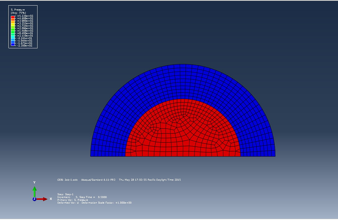

Attached is the result from ABAQUS.

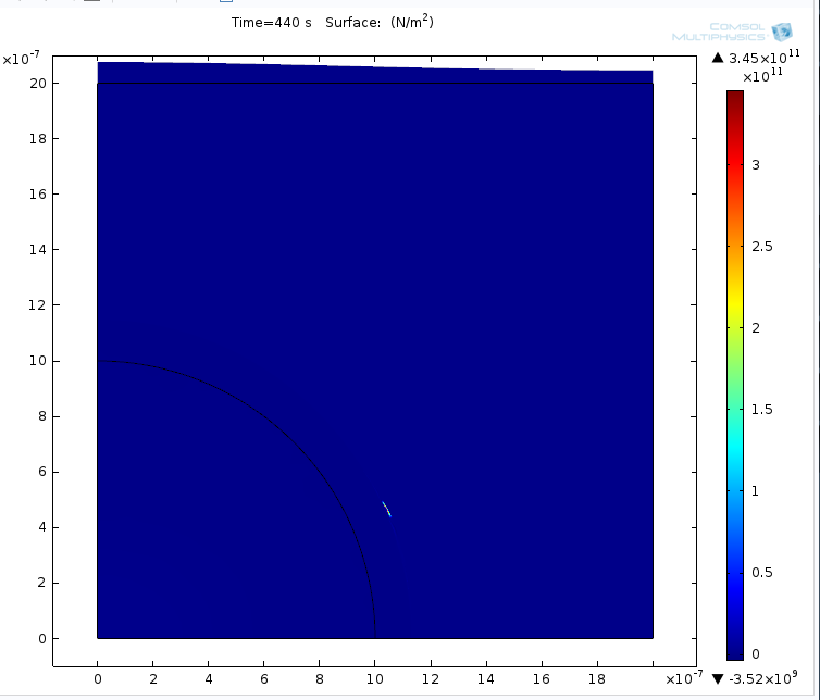

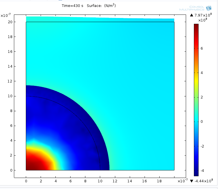

Thanks so much! This model is just a simplified model. Even I build an axis-symmetric model (attached is that axis-symmetric model). It cannot converge yet. So I think it is not because of the axis-symmetric frame. Is it because the difference of Young's Module between two materials is two large?
According to the thermal expansion coefficient, finally I need a 50% thermal strain, so for simplification I set CTE equals to 1 and the temperature equals 50 0.5. Of cause I can define CTE as a smaller value while the temperature gradient would increase. So I think the result is the same. Thanks!
