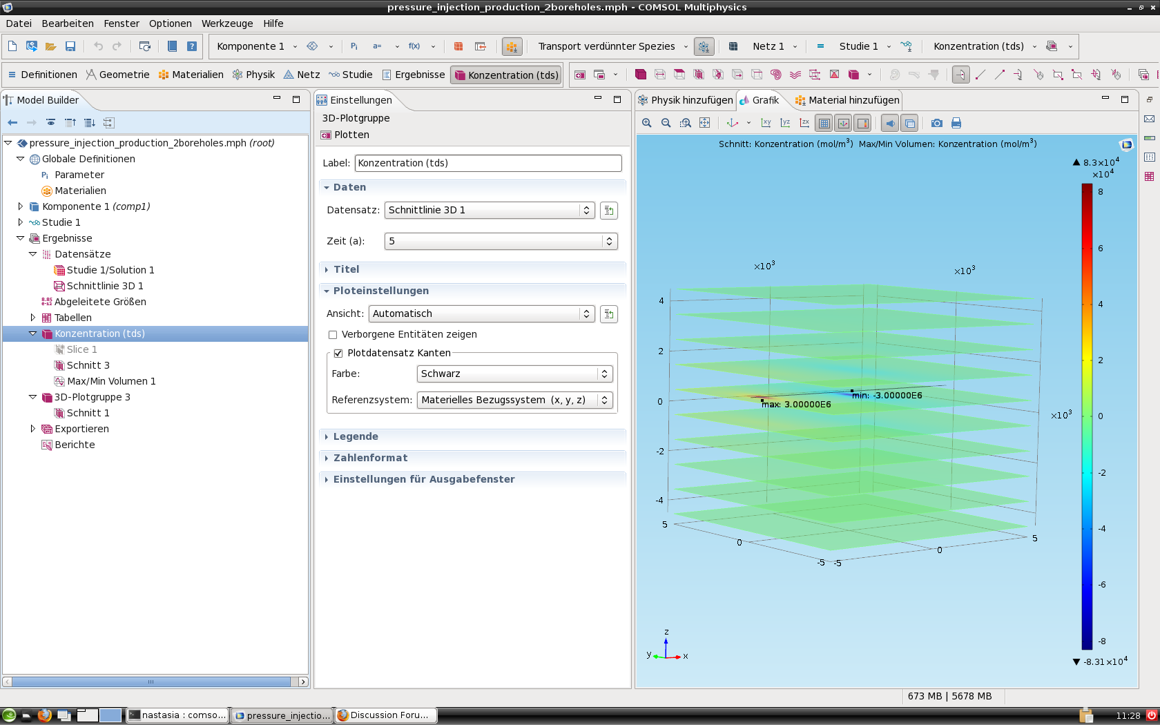

i want to draw the distribution of my results along a line (here diffusivity along coodinates). I have created a
3D- cutline. Where can I show the results or implement this line?
Attached you can find a screenshot.
Thanks and Cheers
Nastasja

You have to make a new 1D plot, and a liner graph under that.
br
Lasse
Hi You have to make a new 1D plot, and a liner graph under that. br Lasse
