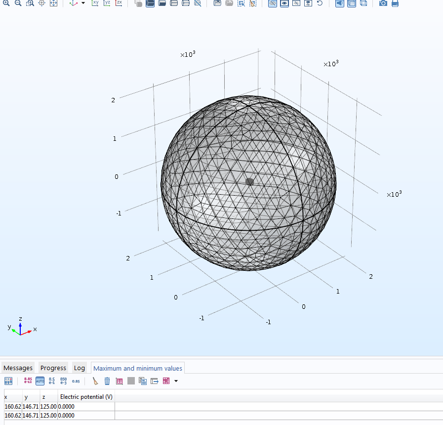

COMSOL uses first order shape elements when the low quality or inverted flag appears, this means that these regions might be less precise, but there is not a clear 1:1 rule here.
Plot the element quality, if your min/max dimensioning values of your design comes from the same corners where the mesh quality is bad, then I would not trust the simulation, and would redo a mshing campaign
A general comment: use the latest version and not the early 4.0, you will be less frusttrated ;)

Hi Ivar
I have multiple layers surrounding to each other and I set mesh size normal for external sphere and set custom for other layers and changed min. element size according to warnings. eventually, there is no warnings, but when I plot max/min volume, it gives the same coordinate as shown in attached file. It means I should not trust my simulation results?
Any helps will be appreciated. Thanks

Hi Ivar
