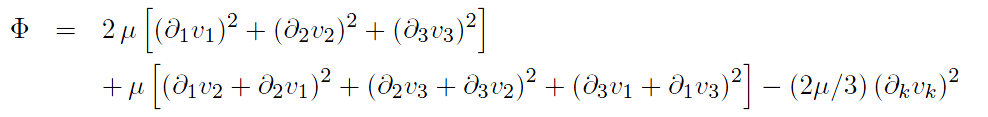

I'm trying to figure out what the equation of dissipation density in pressure acoustics fluid model.
Originally, dissipation function is related to spatial derivative of velocity.
I used the equation I attached here to get the same value from acpr.diss_visc.
But the value from the equation I made was totally different from that of acpr.diss_visc.
Is there anyone who tried to make it before?
