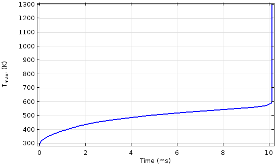

Antia,
Add Free Tetrahedral node and set Element Size to Finer. After 10 ms temperature is exponentially growing, as shown in the attached image.
Sergei
Antia, Add Free Tetrahedral node and set Element Size to Finer. After 10 ms temperature is exponentially growing, as shown in the attached image. Regards, Sergei

When I do exactly what you said, the reciprocal of step size starts to increase after overall progress reaches to 56%, ultimately leading to convergence error. Did you add stop condition to prevent it from going to inf? Or did you change any solver config to have that graph?
Thank you for fast response Sergei! When I do exactly what you said, the reciprocal of step size starts to increase after overall progress reaches to 56%, ultimately leading to convergence error. Did you add stop condition to prevent it from going to inf? Or did you change any solver config to have that graph?
