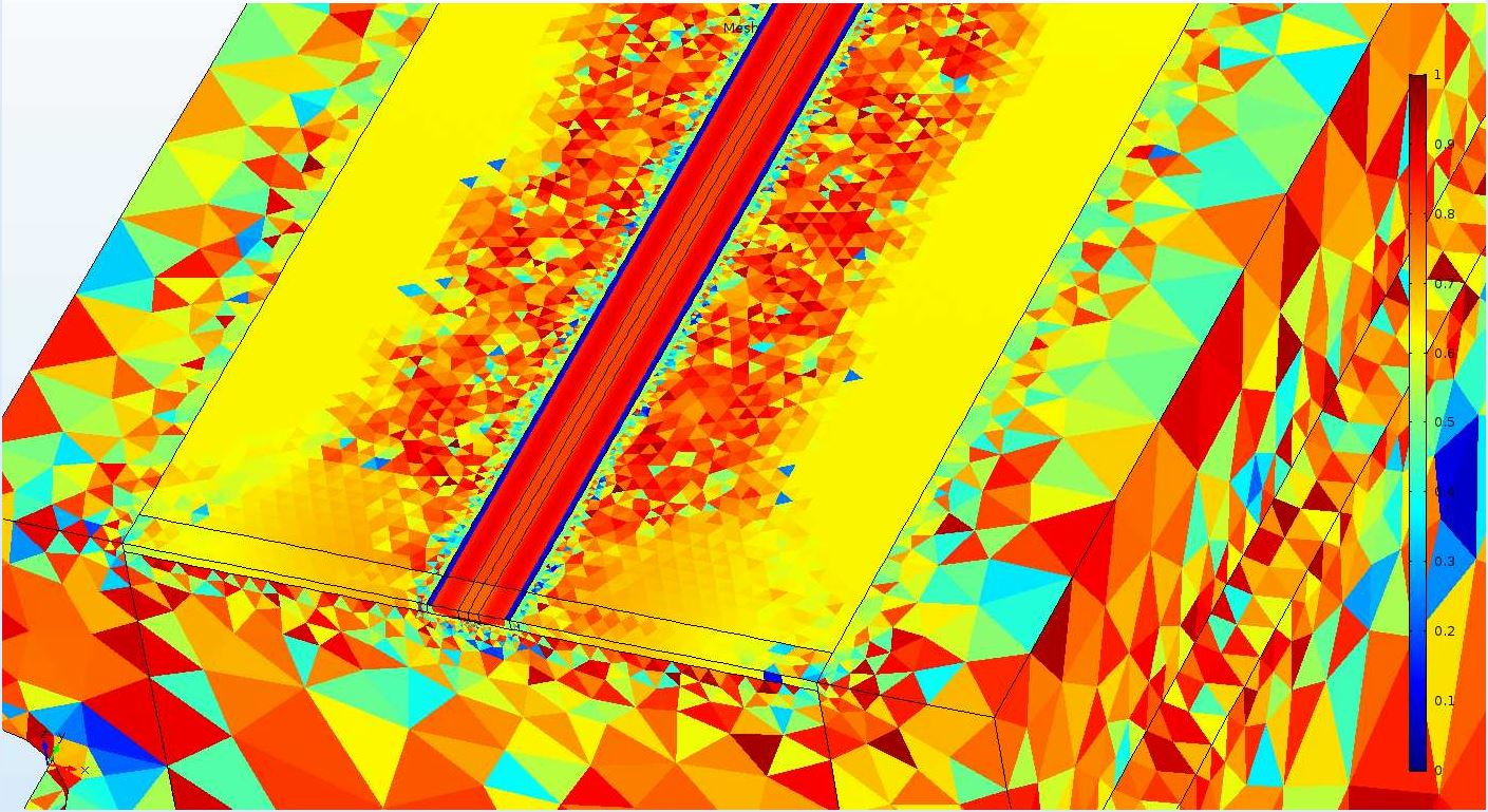

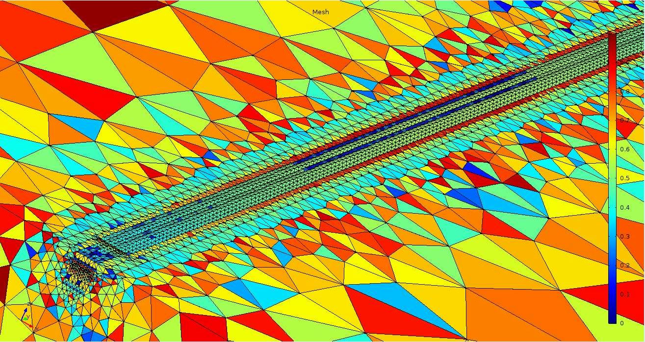

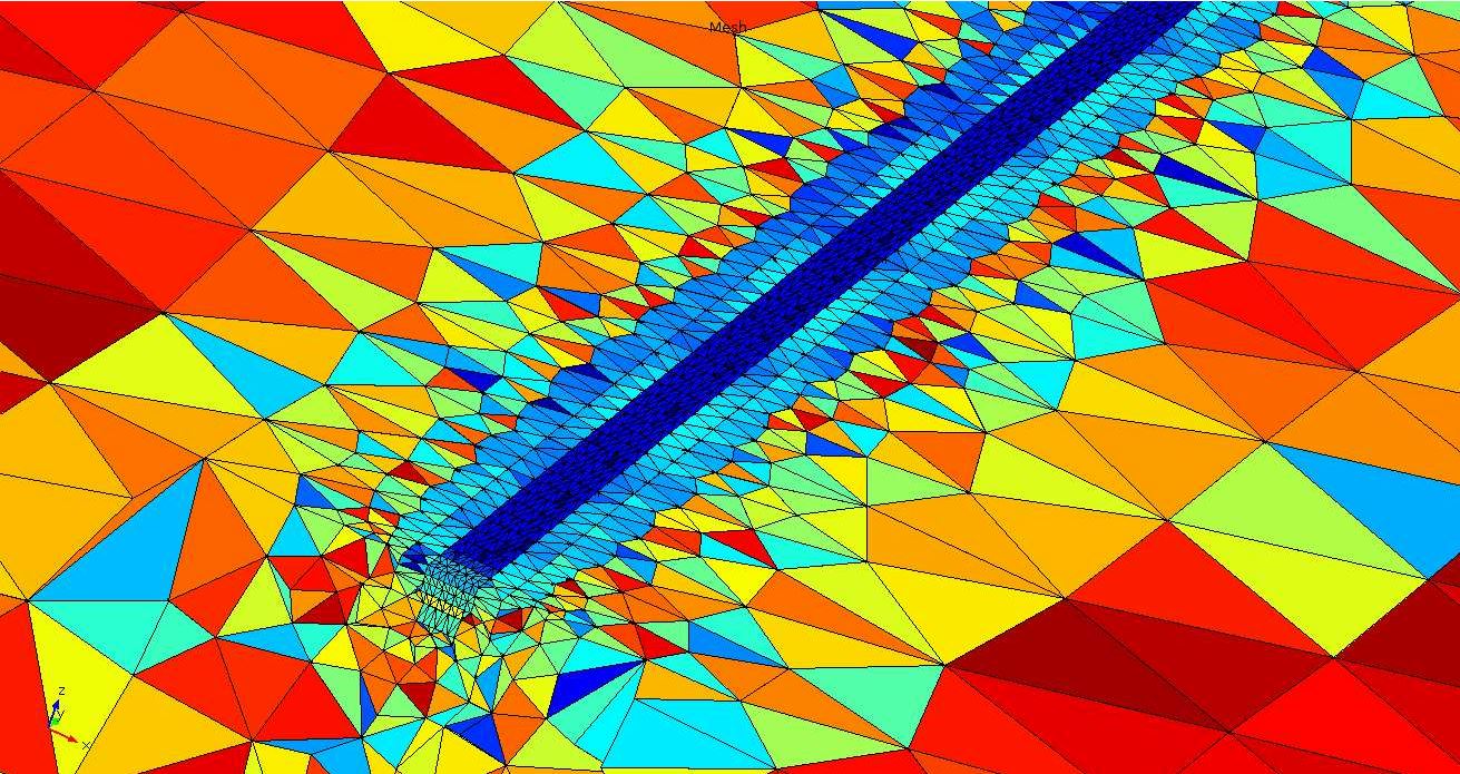

Hi guys, I attempted to solve my mesh quality problem by creating successive layers of blocks with incrementally lower and lower maximum mesh size but it appears that mesh quality is now lowest in the area where I want it to be highest. I have attached a screenshot of a mesh volume quality plot where I tried a free boundary triangular mesh on the top center block and made the max element size very low - but the quality is still poor and strange. I also attached a mesh quality plot of a cross-section of the same model and basically identical mesh. I can't figure out why the quality would be so poor in the center where the element size is set to be smallest. Do I really need to make the elements that much smaller?
Please let me know if you have any suggestions. Thanks very much!

Mesh quality is a measure of the stretched nature of an element not of size. You can have large elements with poor quality or small elements with poor quality. If elements have high aspect ratio they have a lower quality. It is hard to see from your images, but perhaps your z-height of the domain of interest is very shallow so the elements with low quality are small yet the z-height is very, very small causing the stretching of the tetrahedral elements.
Also note that having some lower quality elements doesn't necessarily mean an unacceptable solution. Most meshes are going to have at least some elements with element quality on the lower range of the spectrum. If you are running into convergence difficulties or your results are mesh dependent then you will want to consider adjusting mesh resolution and improving element quality of the worst offenders.

Thanks again for the sage advice Josh; I am beginning to understand that and I actually found the explicit expressions by which quality is calculated. I'm going to have another look at the model today and hopefully resolve the issue.
Also - I think you hit the nail on the head about the z height of the domain - perhaps I can change the mesh scale in that direction?
Nick
