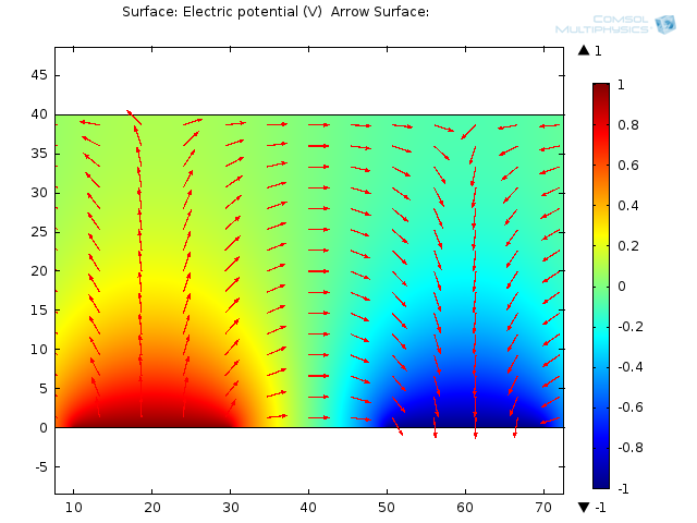

I am newbie in COMSOL,
When I used "Electrostatic Module" to solve Laplace's equation, I need to visualize the Electrical field by arrow, just direction, no need to magnitude
I tried to plot by Arrow Surface but I can not find any option to disable the magnitude of arrow.
The Coloring and Style section in the Arrow plots contains an Arrow length drop-down menu. Set it to Normalized.

But I saw that all arrows is same colour. So how can I setup the colour scale for arrows corresponding to their magnitude ? I mean that the arrows will help me to visualize the magnitude via colour scale while the length of them is uniform.
P/S: In box " Colour and Style", I did see any option like " Rainbow"
Thanks in advance

Right-click on the arrow plot and select Color Expression. This adds a subnode where you can define the expression for the arrow color. You can also choose what color table to use.
