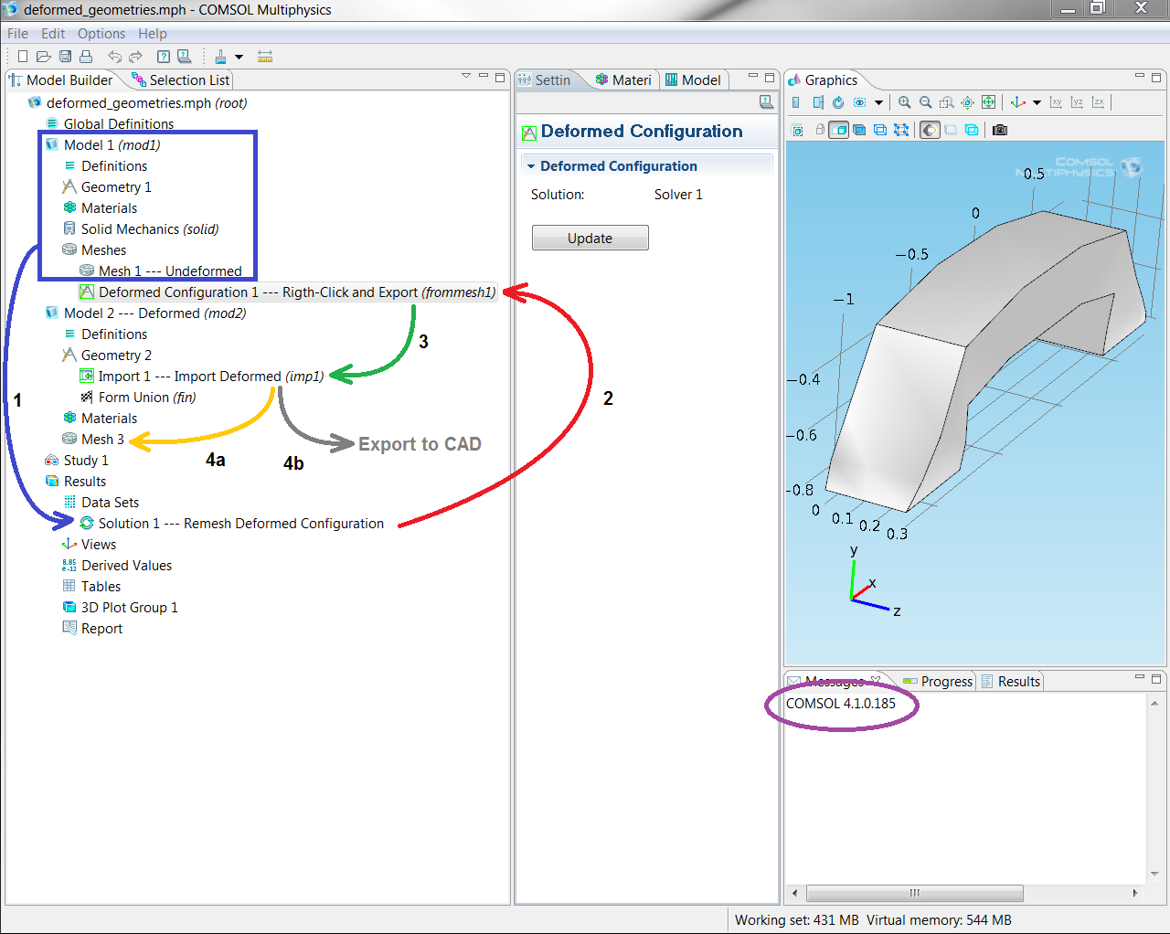

Hi Austin
Have a look at the attached picture on how to remesh a deformed geometry and export to CAD or reuse it in a new model. This was done with version 4.1.
Zoran
Hi Austin
Zoran

Thank you Zoran, very useful, I've been trying to find out how to do this for ages.
Richard
