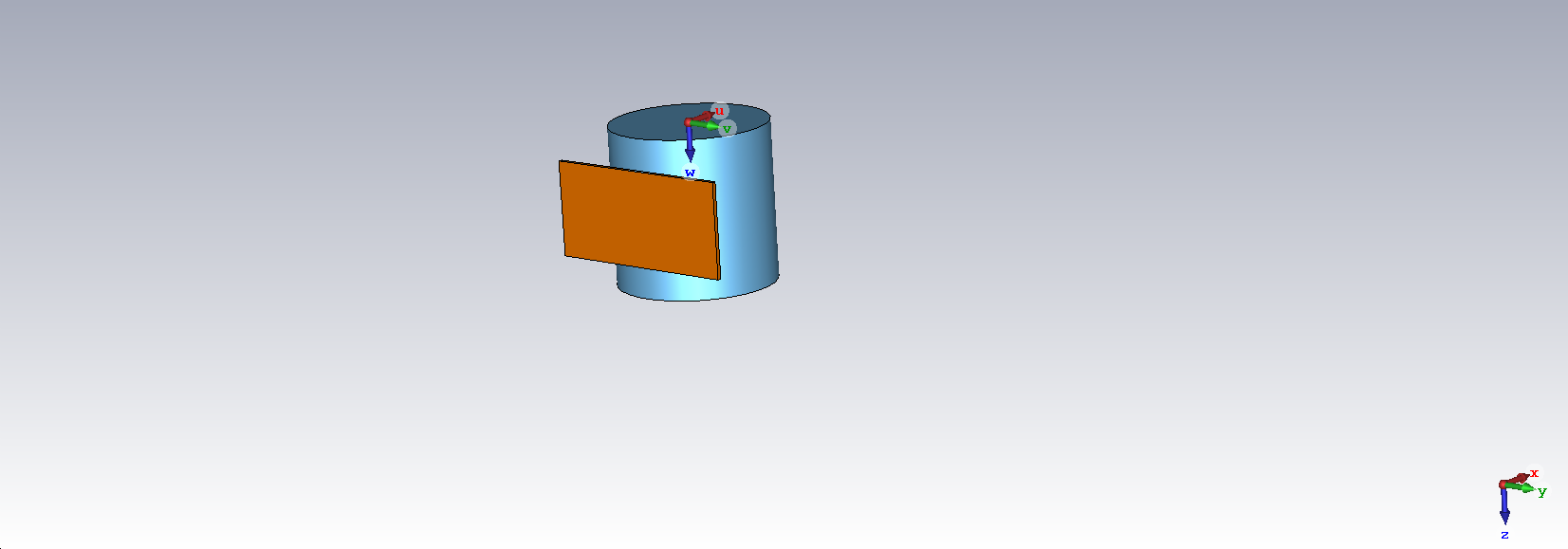

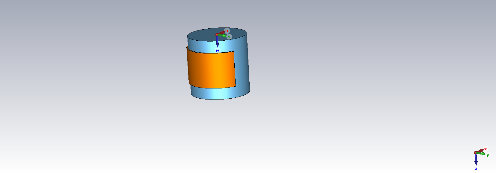

Hi Henrik, I've attached two pictures to show what I actually want. Is this possible to bend a sheet around a cylinder in the geometry node before using any contact? Since this option (bend tool) is available in other similar softwares (like CST) and i'm wondering if its possible with Comsol as well. Kind regards, Shaghayegh

Is this what you are after? Your reference to the geometry node suggests that you are asking about how to define the geometry. If so then it is just a matter of using boolean operators enough times.

Great. This is exactly what I wanted.
