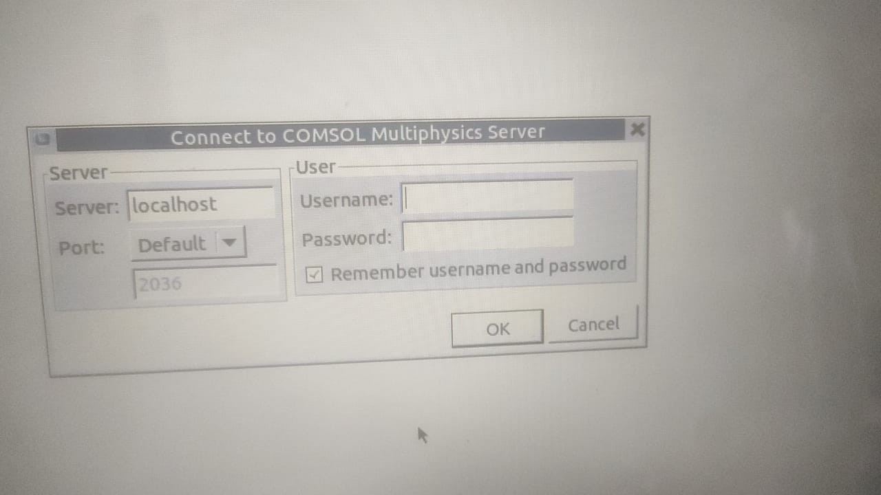

I am trying to connect to livelink for MATLAB from COMSOL. It asks for username and password and I am unable to understand what to put here. Kindly help.

The username and password in this situation is for protecting the Comsol Multiphysics Server from abuse from other people (most people don't have to worry about this).
You can enter anything you want.
If you are only making local connections you don't have to remember what you entered, but if you are making connections from another computer you have to remember what you entered. You can always reset the username and password.
