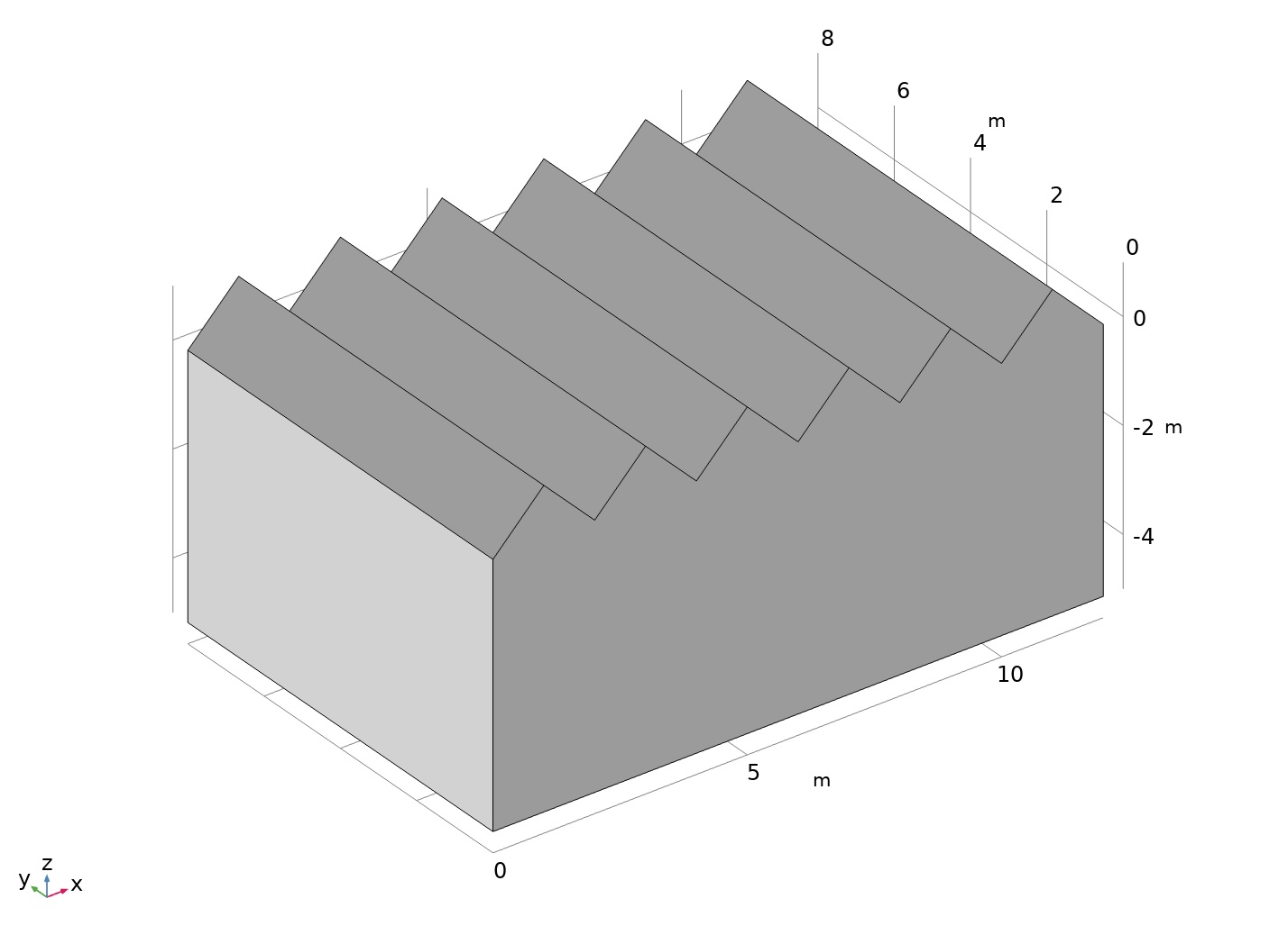

  1. Create a workplane.
  2. Draw your 2D structure, using the polygon tool.
  3. Extrude your structure into 3D. I've attached an example. In the workplane, I used the polygon tool, the array tool, and the union operation.
1. Create a workplane. 2. Draw your 2D structure, using the polygon tool. 3. Extrude your structure into 3D. I've attached an example. In the workplane, I used the *polygon* tool, the *array* tool, and the *union* operation.
