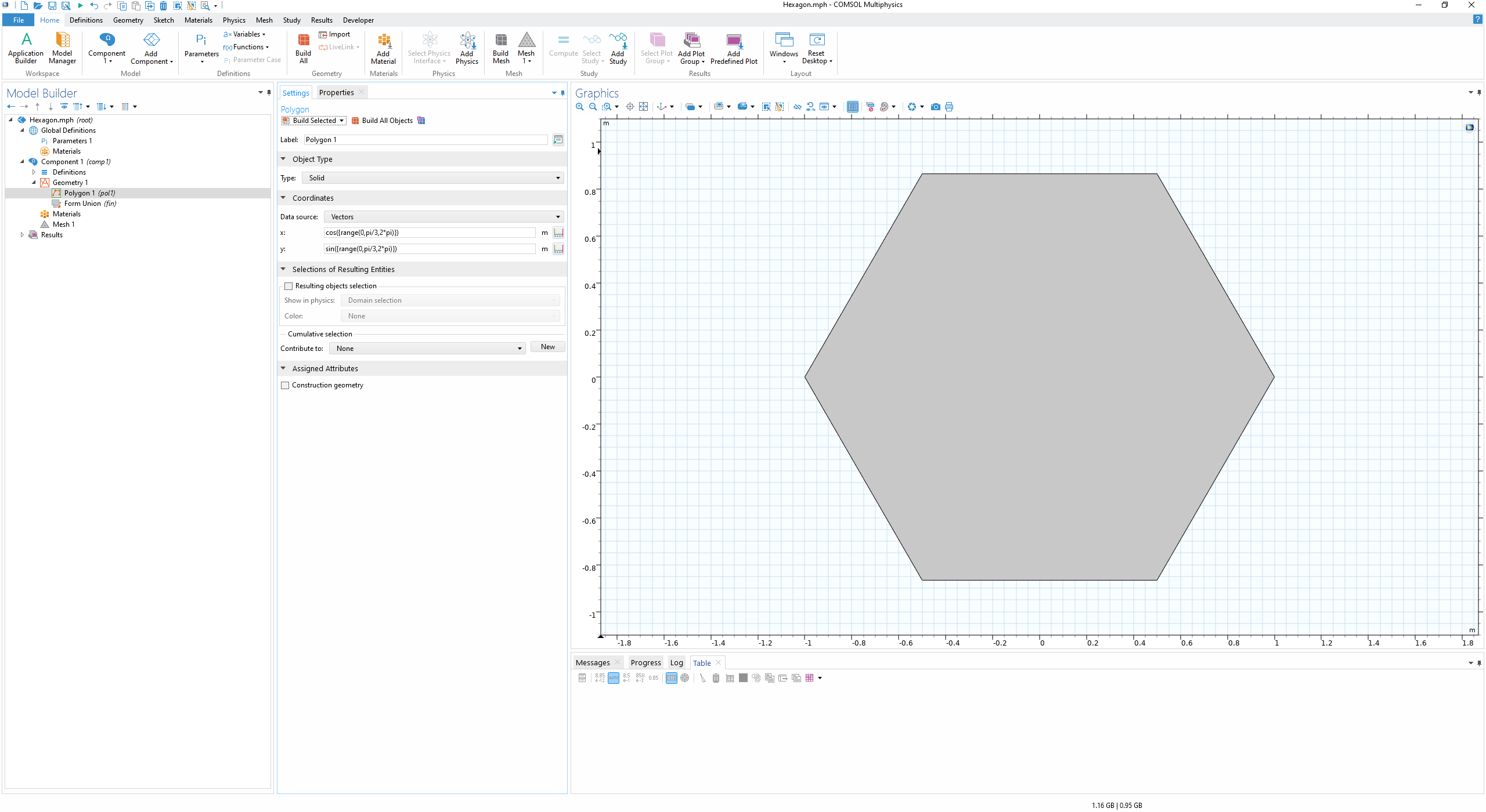

thank you for your response, actually i did not find the formulas for the hxagonal nor octagonal spirals. the equations and the paramerters for circular spiral well explained here https://www.comsol.com/blogs/how-to-build-a-parameterized-archimedean-spiral-geometry. but there is no the explaination for the above spirals

Hi again,
You will find the formulae in the file Hexagon.mph attached to my post in the thread I mentioned. In case you are unable to open that file, you can see them in the attached screenshot.
