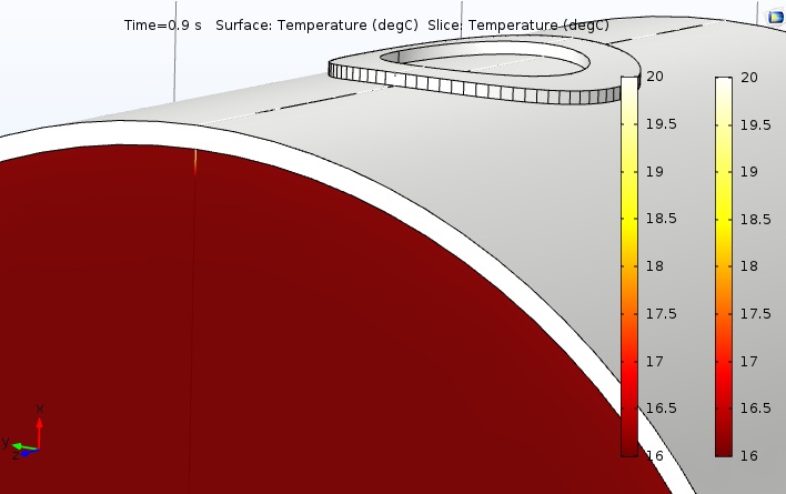

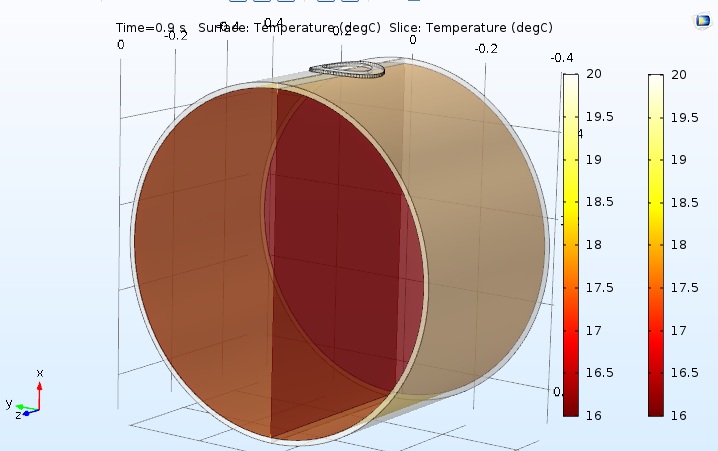

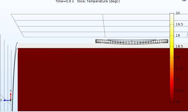

Posted: 8 years ago 27 feb 2017, 12:18 GMT-5
i attach pic for my project, you can see thickness not influance with fluid temperature i dont know why?!, any ideas?
i form an Union in geometry
i attach pic for my project, you can see thickness not influance with fluid temperature i dont know why?!, any ideas? i form an Union in geometry
